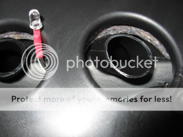

5) Run the first LED wire through the far left a/c hole opening and up to the dimmer switch wires. Let the bulb just hang with about 4-6 inches of wire exposed. Connect the positive BLACK/WHITE wire to the SOLID GRAY dimmer switch wire. Run the negative SOLID BLACK wire to the SOLID BROWN dimmer switch wire.
6) Run the second LED wire through the far right a/c hole opening and snake that wire to the left to meet up with that 4-6 inches of wire. Again, leave about 4-6 inches with the 2nd LED wire for the 3rd LED's wiring later on. Use a wire splicer to expose the 1st LED's wires for the 2nd LED wires to piggy-back off of.

8 ) The 3rd LED light will go where the far left a/c hole opening is. Attach the wires to the end of the clothes hanger and push it through the small opening closest the firewall.
It will easily come out the driver's side area.
9) Leave that wire on the driver's side for now and focus on finishing up the passenger's side. The 4th wire will go where the far right a/c hole opening is. Splice the wires from the 4th into the 3rdÂ's.
