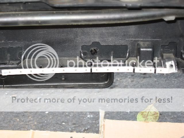

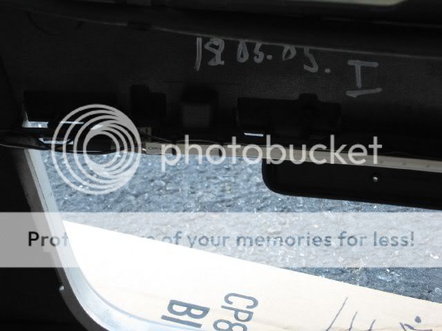

8 ) Clean area where the LED bars will be mounted. Remove the film protecting the sticky 3M's on the light bars. Here's a pic of where I mounted mine (in my opinion it's about the only spot you can get them)
They are placed so the wire-side of the bars piggy-back to the driver's side (both bars' wires are facing left).
9) Once both LED bars are in place, use zip ties the reinforce that the light bars will stay in place. Be careful not to cover up any of the LED's though. And run the LED bar to the right underneath the zip ties that are holding the left LED bar in place (for a cleaner install).

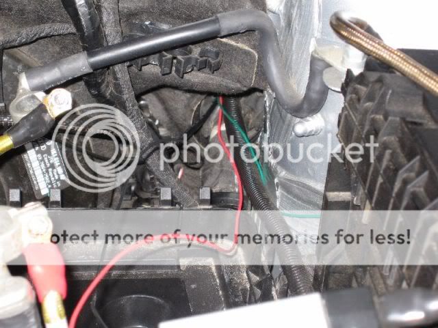

11) Remove the battery. I KNOW, it's a pain the butt (especially if you got extra wires coming off of it). This is the only way to snake the wires through the firewall.

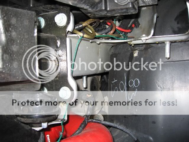

12) I used red+, black-, and green (accessory) wires, and I placed a heatsink tube around the end I was going to push through the firewall so all the wires make it through easily (you don't have to do this but I recommend it). Make a few cuts in the firewall's rubber grommet area where all the wires are going through. Then snake your wires through the hole you made.
I ran the green wire around and under the fuse box area so it's out of sight. You'll be able to easily see it underneath the driver's side headlight.

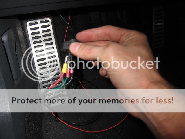

13) Connect the red, green, and black wires to their prospective terminals on the accessory switch you bought (I'm throwing this step in here now so you can test the LED's before you go through all the hassle of mounting the switch). It is a good idea to place some electrical tape around the black and red terminals just for peace of mind (wouldn't want an electrical fire would we?).
14) Reinstall the battery, but don't put on the plastic coverings yet. Connect the red+ and black- wires to their prospective battery terminals.

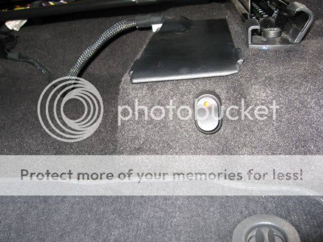

17) There's a few options for switch mounting locations inside the vehicle. I chose to put my switch down by that bulge in the floor to the left of my driver's seat. Placing it next to the traction control button just looked tacky in my opinion. There's a separate DIY for mounting the switch if you want it in the same location as this.
