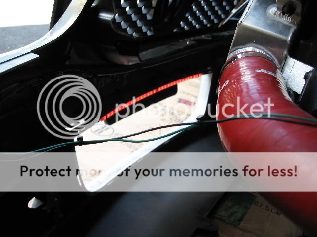

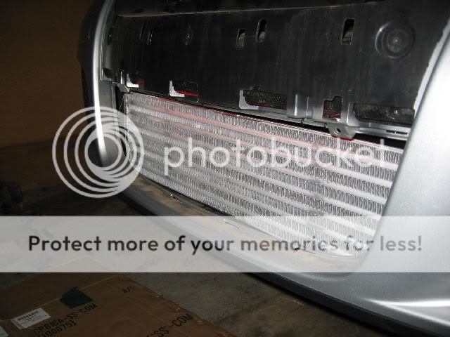

8) Clean area where the LED bars will be mounted. Remove the film protecting the sticky 3M's on the light bars. Here's a pic of where I mounted mine (in my opinion it's about the only spot you can get them)
They are placed so the wire-side of the bars piggy-back to the driver's side (both bars' wires are facing left).
9) Once both LED bars are in place, use zip ties the reinforce that the light bars will stay in place. Be careful not to cover up any of the LED's though. And run the LED bar to the right's wires underneath the zip ties that are holding the left LED bar in place (for a cleaner install).
