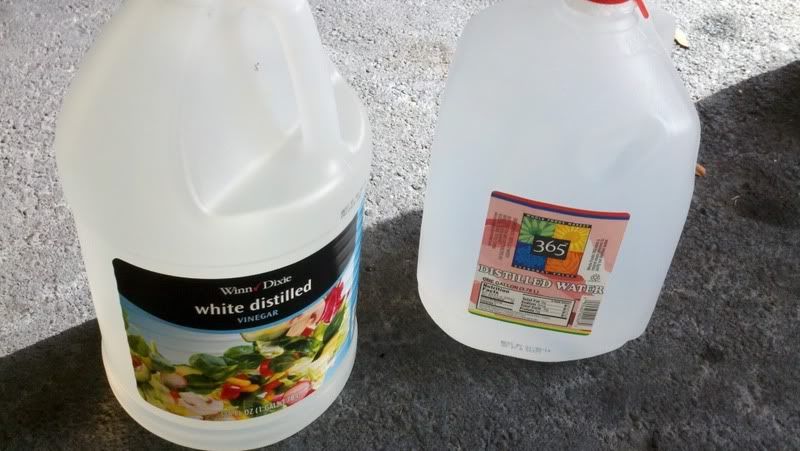

7.) 1 Gallon White Vinegar ($2.99, optional, more later)
8.) 3 Gallons Distilled water ($.99, Only need one unless pursuing optional portion)

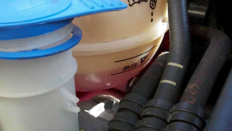

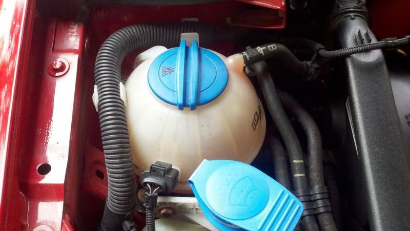

1.) Begin by popping the hood and unscrewing the Reserve Coolant Tank in the top left corner of the engine bay. If your car is hot, let it cool down, a face full of steam does not a good day make.

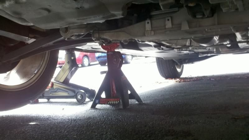

2.) Chock the rear wheels, set the parking brake, and jack the vehicle up, and place the jack stands on the appropriate points on the vehicle. Use T25 Torx to remove belly pan. I tend to leave the jack on the working side - just in case.

3.) Optional portion for contaminated systems such as mine. Mix white distilled vinegar and distilled water to the ratio of 50/50 and pour into the coolant reservoir. Leave the cap open until the end.

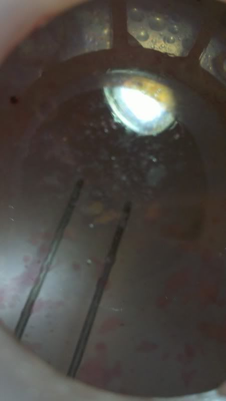

These globs of chunky mixed coolant mud were mixed until the vinegar got to it

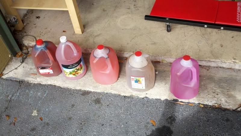

At the very least, the last cycle should be ONLY water to flush out the remaining vinegar. Various flushes (four total, left to right, replacement coolant right)
5.) Mix G12 ++ coolant with water at 40/60 for -13 F 50/50 for -31 F and 60/40 for -40 F. For 06 and 07 GTI's coolant capacity is 7.8 Liters/ 8 Quarts; for 08 and 09 GTI's coolant capacity is 8 Liters / 8.4 quarts. Add to reservoir with engine running until coolant mix is between min and max lines. Make a bit extra and go for a drive, stopping after the first 1/4 mile or so and adding coolant when needed. DO NOT OVERFILL. It's better to start out at the min and add when you get home that to fill it to the top and crack the reservoir.
