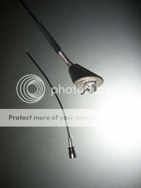

So I came home from work a few days ago, and my wife comes up to me with that 'look' and says, "Something happened today, and I want you to keep in mind the time that the extension ladder landed on the hood of my car when you were on the roof..." (Don't you love it when they preface a conversation with a don't-be-mad-at-me-because senario?). Anyway, she somehow managed to back her car (mkIV Passat TDI) out of the garage when the garage door was on it's way down and ripped the antenna straight off the roof and dented it. The rubber gasket on the antenna ripped. The wire snapped in two, and the threading on the base of the antenna stripped as well.

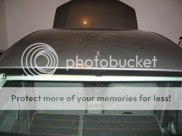

2 - Here's what we're working with:

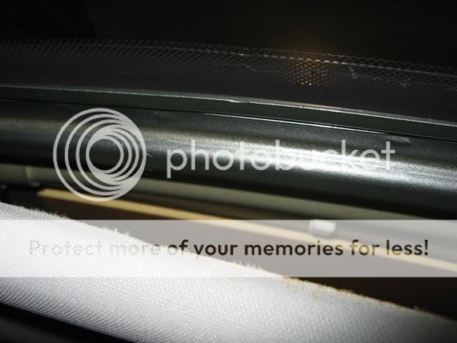

The roof had to be hammered out a little bit on my wife's car to form a good seal around it with the rubber gasket.

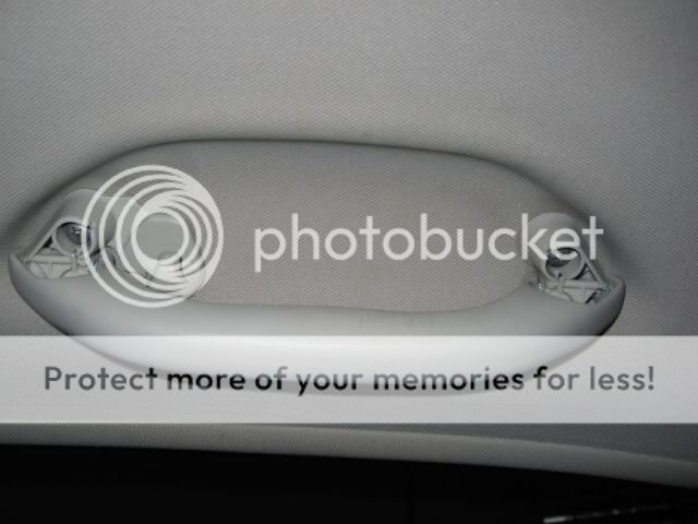

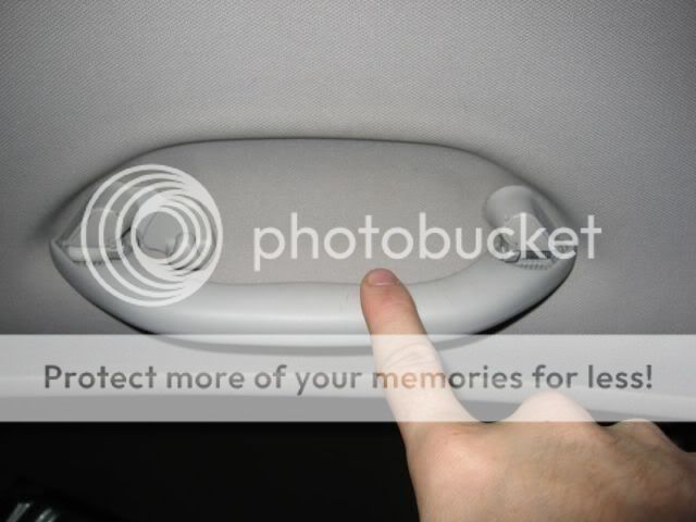

3 - The rear hand bars will need to be removed...
Nothing really to it. Simply pull back on the clips until they lock the bar in the down position exposing the two philips screws:

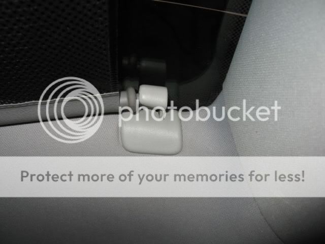

4 - Locate the two rear headliner clips that are on each side of the rear sunvisor brackets and carefully remove them (I had to use a flathead screwdriver to aid in removal):

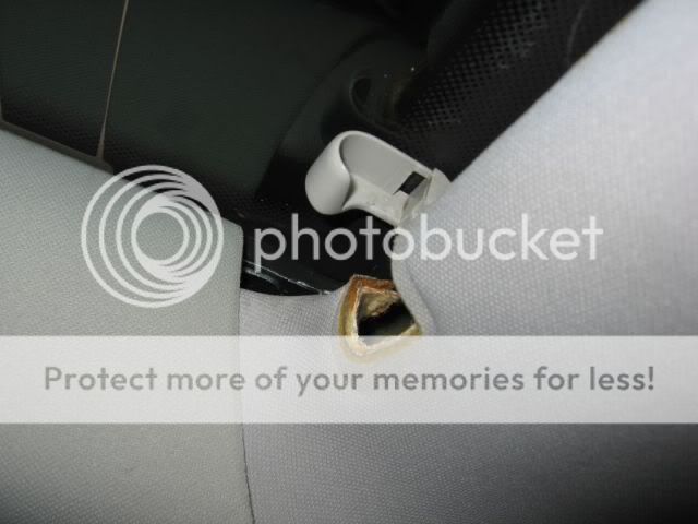

5 - Carefully pull back on the side column lining just enough to allow the headliner to clear over it's overlap (do this on both sides):
6 - Peel the headliner board back by hand (it's a tongue-and-groove connection):

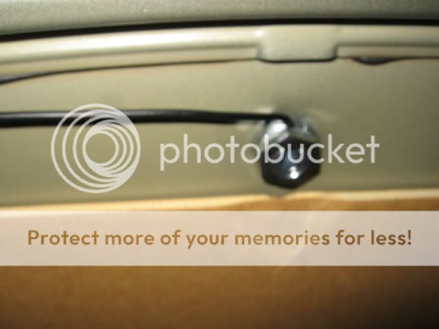

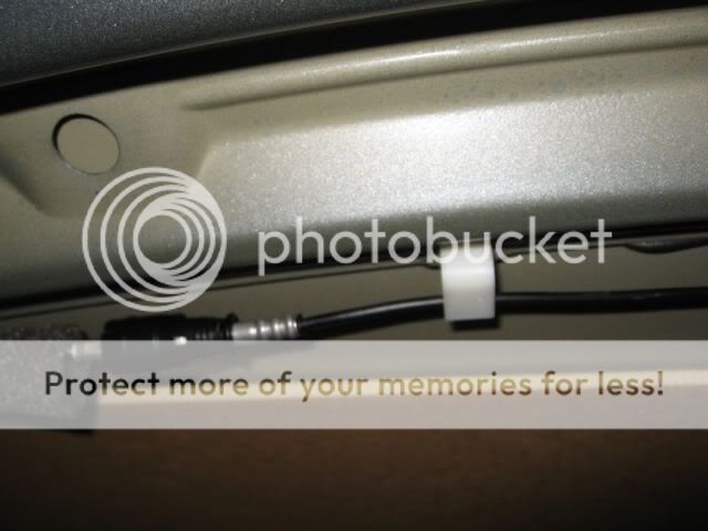

7 - You'll see where the antenna wire connects to the lead to the headunit. Simply separate by pulling on both clips. The lead clip is spring-loaded. For re-assembly (after the antenna base has been fastened in place), simply push the two connectors together until they 'snap' in place:
8 - Note that the antenna wire travels through the opening of the washer. Not through the bottom of the nut:

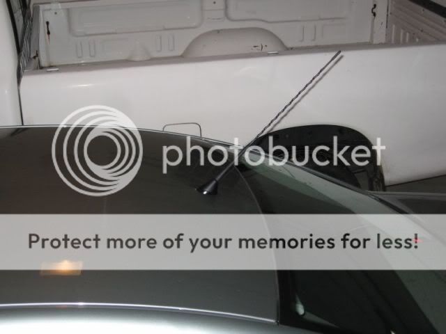

And you're done:
